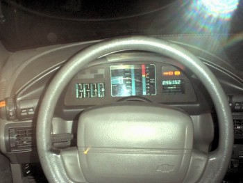

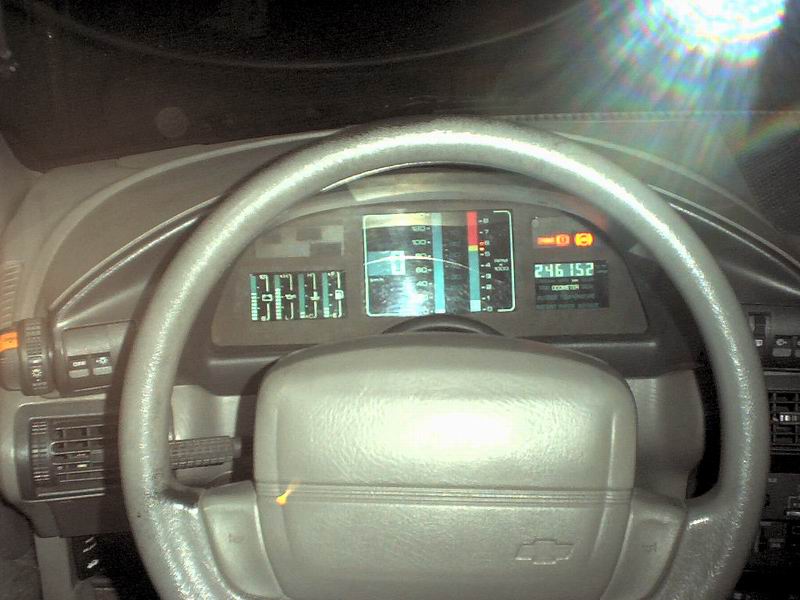

Okay, so I have been working on grafting-in a late '80's Cavalier digital instrument cluster into my '90 "T-Type" 'Retta. The main reason for doing this is that I put in a good salvaged Cavy 5-speed transmission into the car, and the Cavy uses a different VSS (Speed Sensor) than the Berettas do, so my original speedometer was inoperative (I was using a Fiero speedometer temporarily hooked-up until now). I like the look of the Cavy's digital display, and got one cheap from the junk-yard.
But, I was having some trouble with the instruments powering up correctly, and started looking around at some other options... Then I ran across this online:
:shock: :Bravo:
I now have two Berettas with the digital dash instrument option, I have three or four spare clusters for them and two ECMs to run them, and have intentions of swapping one into my '97 turbo Z-24 just to be different, so I know what they look like. And I know they did NOT come in green, and I know they were not offered in the '91+ Berettas. I am not too surprised that someone took the time to graft one in to a later-style dash, but although I've looked superficially into changing-out the backing lens for the display with another color, I wasn't really sure it could be done. Now I'm pretty sure! 8)
So, does anybody here recognize this car? It looks like a base-model (judging by the seats), obviously manual tranny, and that looks like a really clean conversion. I just thought I would share this with everyone here, and see if anybody knows who did the work, or if I am missing something terribly obvious to anyone who has gotten a full night's sleep this week.
Re: GREEN digital dash!?
That is an OLD picture... IIRC, they did a newer dash swap. It has a Corsica cluster "hood". I remember them taking the cluster apart and removing the orange lenses from the inside. Who did it, I couldn't tell ya... it's around here someplace though.

heavywoody wrote:That is an OLD picture... IIRC, they did a newer dash swap. It has a Corsica cluster "hood". I remember them taking the cluster apart and removing the orange lenses from the inside. Who did it, I couldn't tell ya... it's around here someplace though.
Yeah, that is defiantly not original, they did not offer it on the new dashes. Looks worse IMO than original.

That's a full Corsy dash. Look at the passenger side in that one pic of the spot where you can put stuff. At least it looks like one.

I'm glad it is on here somewhere, at least the info was available before. Like it or lump it, I still think it was a clean install, and the different-than-orange color-scheme is a refreshing change to me, knowing now that it is indeed possible to swap-out the lenses and change the color makes me certain that I will be doing so to my teal Indy, and maybe someday even to the GTU (although I am thinking either white or even multi-color LED for the GTU).
I had plans to drop-in a '91 S-15 digital instrument package into the Indy (because it is something different than what is in my GTU, I have a freshly rebuilt one I picked up for cheap, it is an attractive-looking dash, and it illuminates in that more typical blue/green color that more closely compliments the Indy's interior accents than orange), but now I will just swap-out the backing lenses for the original instruments instead -I'm much happier with that decision.
I thought something looked wrong with the dash, but I wasn't certain as I only have/had one later-style interior Beretta, and its' dash was so far gone (I still have a mint replacement, but I don't know if I'll ever have the chance to swap it in now), and I wasn't looking too closely at anything but the instruments. Corsica makes sense, thanks for putting that in.

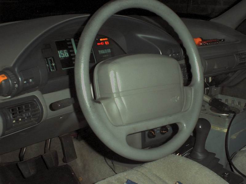

I recently changed my digital dash color, by removing the orange from the back plates (now they are white) add color to your choosing and reinstall.

Fast forward much later than when I started this post, I ended up with a Yellow Indy to compliment the Teal one, giving me three digi-dash cars. The cluster had some issues, and when I pulled it I also pulled the orange lenses out and replaced them with a white fibrous 'cloudy' material. With the original incandescent bulbs, it ended up with a warm yellowy-gold glow, matching the Yellow Indy's interior accents very nicely. As yet, I STILL haven't replaced the GTU's lenses though... :( And the blue-on-blue Turbo 'Retta ended up with a digital Olds Cutlass Supreme International cluster, which looks almost like a digitized version of the Beretta analog gauges, including 180-degree sweep (albeit with digital tick-marks that light up around an actual digital number, instead of a sweeping needle) speedo and tach, and it is the traditional blue/green plasma illumination. My 'old' '95 Z-26 eventually lost its' speedometer so I grafted in a '90's Bonneville HUD, which works fine though is a bit bright at night (I haven't put in a dimmer circuit yet, I just don't drive that car much anymore). It will probably get a more aggressive-looking 'rally' type instrument package with 270-degree sweep instruments (possibly built from either a Fiero cluster or a heavily modified 3rd-Gen Trans Am cluster) if I get back into that car enough to spend the time. Fun stuff. :good:
