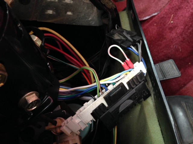

Re: Left turn signal
so after a couple hours on Saturday of reading the wiring diagram I came up with this bypass.
The hazard switch is defiantly the problem, and with this car getting a 1990 black wheel this should get me by for the meantime
the yellow wire controls the front blinker and the light blue controls the back so i just jumped them both together, now the blinker works fine hazards work fine but when applying the brakes the left turn signal lights up on the dash.
regardless the car will now pass inspection !
