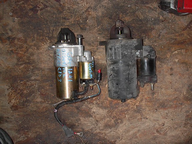

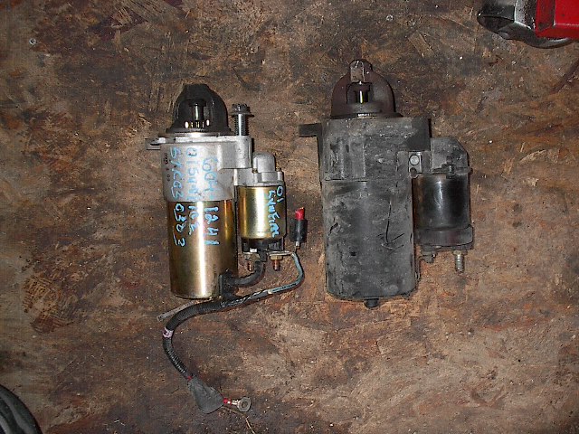

Stencil
Posts: 217
Re: Replacing Starter Motor -> 96 Z26
Post by Stencil »
Here is a comparison of the new vs. old starter size. The space savings is dramatic (REALLY helps with room) and also they are 8-9lbs lighter. I've never had any issues with failure on the newer style units and would highly recommend them.
-Aaron
