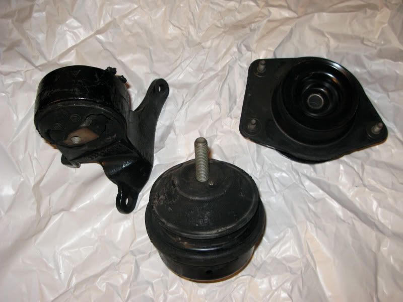

Motor was rebuilt two years ago and has maybe 12k miles on it now. Replaced all sensors, fuel pump, shift cables, Rodney Dickman shifter rebuild, clutch hydraulics, ECM, high torque starter and probably a few other things that slip my mind right now.

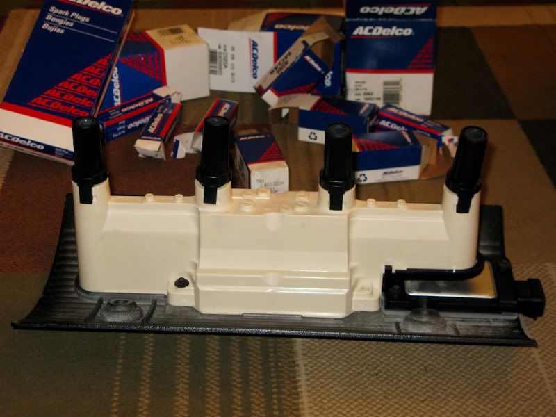

I recently had the engine and trans shored up tight with new mounts as well as a ignition overhaul.

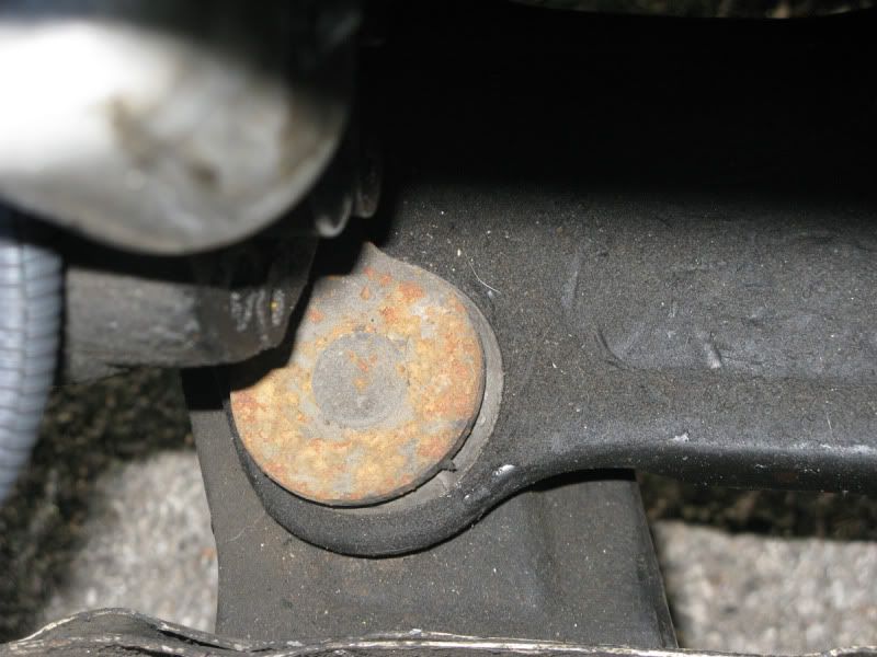

Question: Where can I find new cross-member bushings or is it all one piece? You will have to forgive my FWD ignorance and I've never removed one before.

Also not sure which cross member you speak of... I did not know our cars even had one. I know there are two rails aka sub-frame assy, the control arms come off that, and then on some models there is a cross brace where the sub-frames bolt up into the uni-body but there aren't any bushings involved with any of those mounts. So unless the GTZ has something different that I'm not familiar with then a better picture is in order to figure out where that is. To me it looks like it goes across right behind the radiator support between the two sub-frames.

He's referring to a crossmember which was used for the 90-91 quads which the front motor mount attaches to.

You shouldn't need to replace those, unless you destroyed them removing the subframes. If you didnt take it off dont. They arent actually bushings, more like a spacer. The front engine mount absorbs most of the vibration, and those spacers dont allow that much more to go into the subs and body. If your set on replacing them, ill get you the p/n, but i belive they are n/a from GM.
