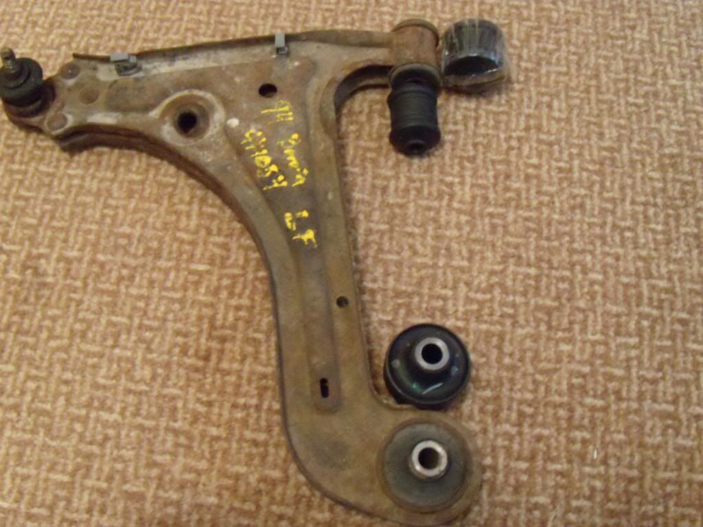

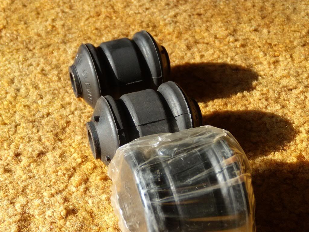

I bought some bushings from Auto Parts Warehouse for my 95. I got GM#89000869(those look right) and 88912674(one box has two small bushings and the other has just one large bushing). If needed I can post some pics. I do have some used control arms to replace the ones on the car, but unless the bushing changes shape when pressed in then the 88912674's are wrong. The large bushing is one size larger than it needs to be. I do have some Moog rears so I know that it's not a rear.

Thanks for the post man. It would the the horizontal bushings that are in question. Sorry should have said that. The vertical ones look right.

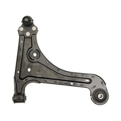

it should look like this...
Oh, and I think that style started in '94. The new rear suspension is what came in '95.

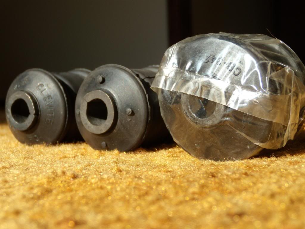

Yeah the 89000869 looks like that. Do you have a pic of the other bushing Cliff?
I find it odd that the bushings in my pics have the same part number. Something got screwed up. There is no way that they can be the same number.

Money Pit, going by the pics you posted, all the bushings they sold you are wrong!
But like I said, the "larger vertical bushing" with the "metal sleeve" around it comes in two different sizes!
The much "smaller vertical bushing" does not have a metal sleeve!

They are all wrong scd88ga? Do you have pics or part numbers?

Here ya go!

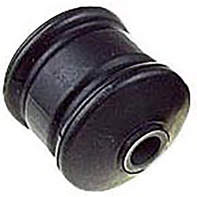

Smaller Horizontal Bushing
http://www.autozone.com/autozone/parts/ ... 47_0_4291_

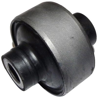

Larger Vertical Bushing
http://www.autozone.com/autozone/parts/ ... 7843_5296_
Ok, now that I looked around a little more, the 2 small bushings you have are correct and work for ALL 87-96 Beretta's, but the larger ones you have are wrong, you will need the ones with the metal sleeve (94-96) and they only come in one size!
94-96 control arms

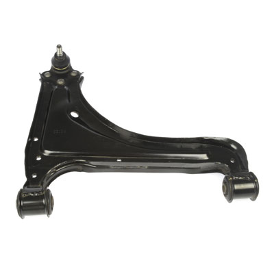

87-93 control arms
94-96 control arms
87-93 control arms
