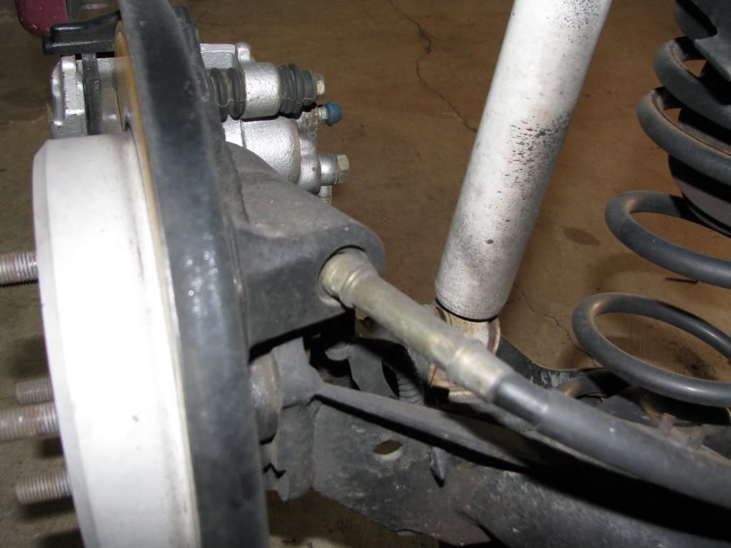

I have my setup with daytona brackets and nonvented rotors and i have neon claipers, rotors, pads, shoes and hardware and i attempted to use the beretta parking brake cables and they seem to be to short.
Does anyone know why they are to short?
Or what cables i have to use?

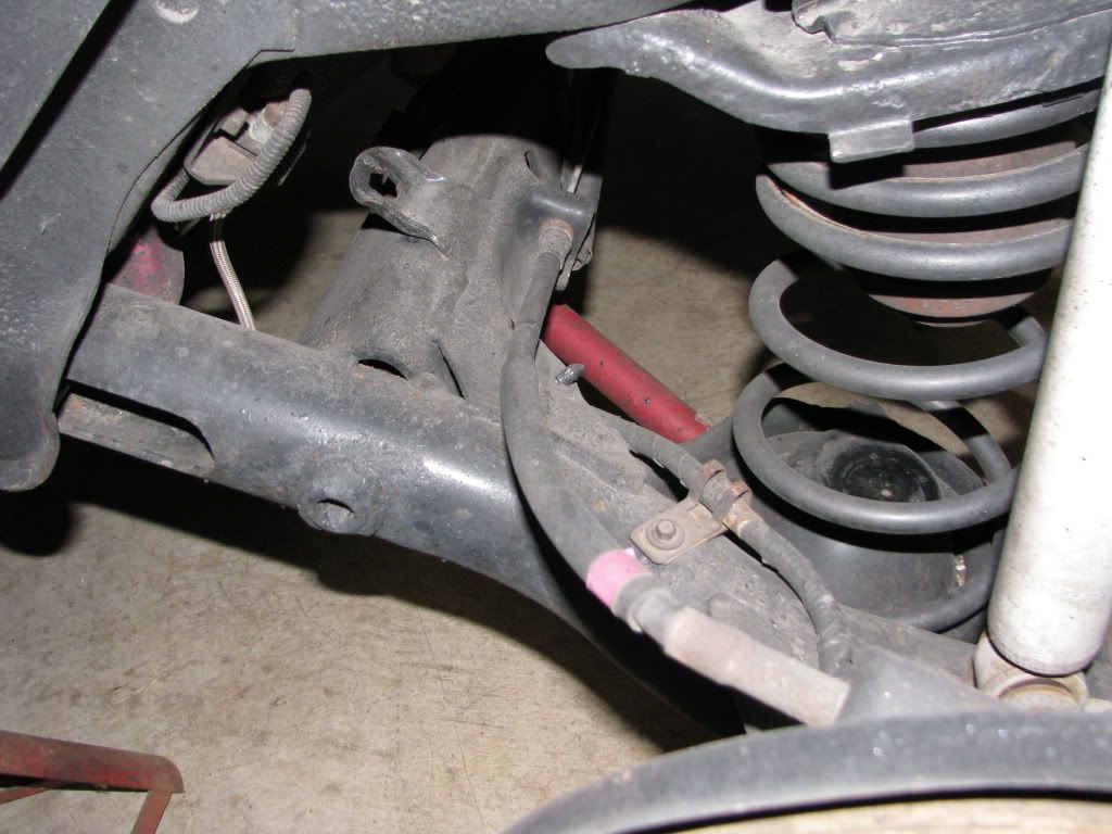

His setup is pictured above, Mine is here

they were about 2" to short per side, and they were brand new cables, anyway to fix the problem i welded new brackets for them to hook into 2" closer to each disk bracket, they fit i just hope i still have enough adjustment
