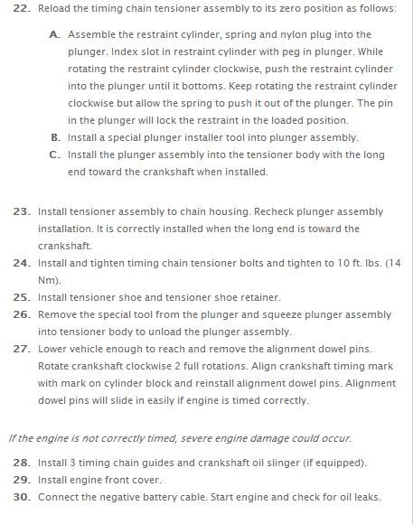

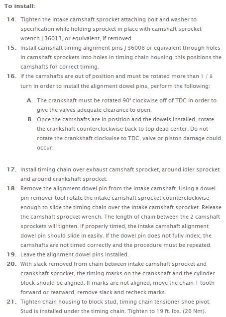

Here's the installation sequence. I use a couple bolts from my steering wheel puller kit to hold the cams in place.
