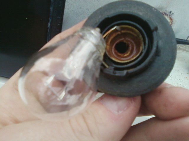

themadness
- Posts: 885
Re: turn signals blowing fuse
hows this for a possible culprit? checked the passenger side taillights. i pulled all the lights to check the bulbs. i got to this one and it basically fell out leaving the metal part of the bulb in the socket. one of the filaments was severed and the bulb was freely spinning in contact. i had to pull the metal part out with needle nose pliers
now i have no brake lights on the passenger side which should be a no brainer at the AZ.
problem solved??
problem solved??
