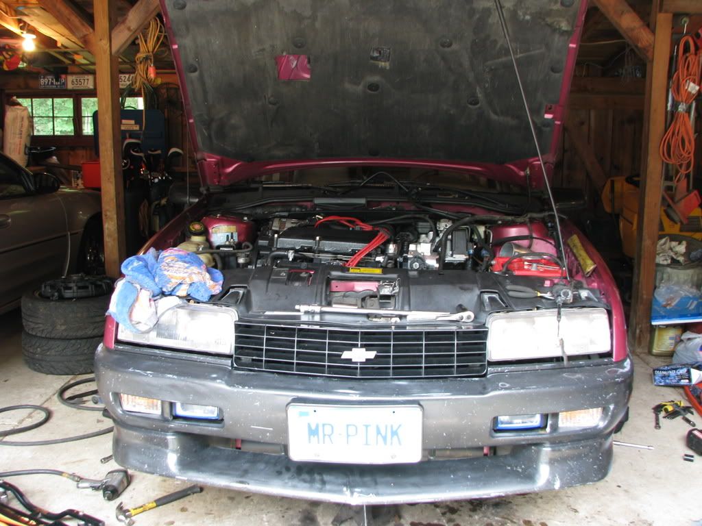

I take my last post back, Mine apparently did hit my hood... I just found this photo... You can also see where the spark plug wires were into the sound deadner, I had to cut out a square there too.
So, deal with it, or sell them... Or buy a US-body hood... those are your options.
