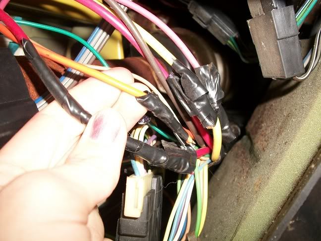

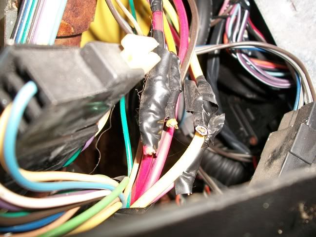

yeah i used spray lubricant and it didnt last long my father has the really old oil gun that i will use next time im there. also about my gauges not working properly i got ready to take them out and this is what i found. i am guessing this may be why they are not working. who ever did this is an idiot.
My 1990 Chevrolet Beretta Indy 3.1L 3 Speed Auto
Re: video of my indy!!
That is not what I wanted to see. My guess the rake guy, looks like his kind of work. Your going to need a Chilton's to sort that out.
Posts: 10923
Thats from an old alarm or radio that used to be installed... It seems to be tapping off the main ignition power wire and something else, but yes get a diagram to see what those two other wires go to.
It doesn't look like anything is damaged other than the main harness wires are stripped back and those are spliced in... but just double check to ensure there isn't just three wire ends twisted together under that tape... if so I would remove the dead end and crimp the factory harness back together.

The wiring is a hack job. He didnt even use the connectors, just taped together. If these wires are for the sterio, why couldnt he just get a 10 dollar harness to install it right? I do have a haynes manual that we can look through.
