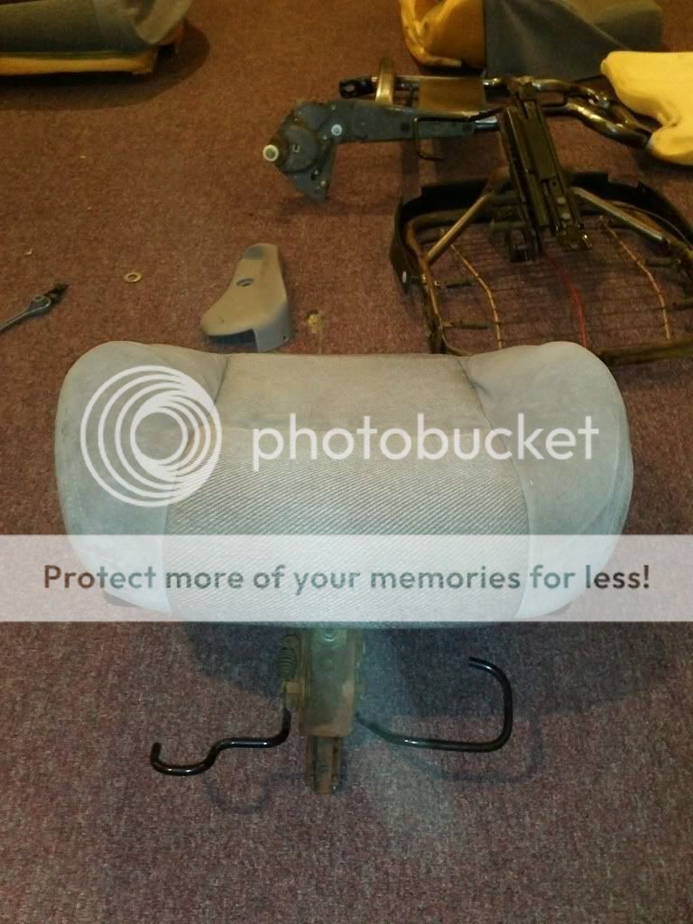

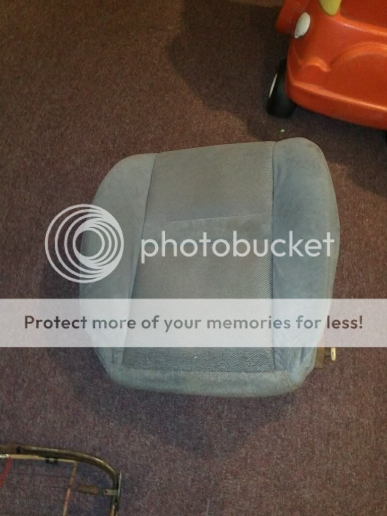

Has anyone tryed swapping the bottom foam from the passenger side to the driver side on the Z seats ?
i have a set tore apart tonight to try it. the only thing i see thats different is the inside hump is 1/8 inch higher measuring the material. i stuck the foam and cover together and put on the base but didnt put the wire clips back in just to try it, it doesnt look bad and i think it could work. just wondering if anyone else has tryed this and what the end result is..

Those cushions are the same as the Indy's and they have the same part no., so they are interchangable. Just a tip...before you put the cushion back on the wire grid, put some scrap material between them. This will help to stop the wires from cutting thru the foam.

it works perfect.

It probably measured different because one was very worn.
