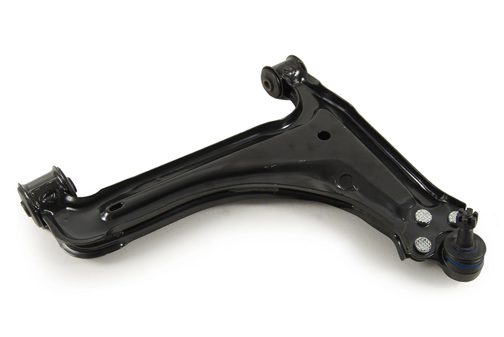

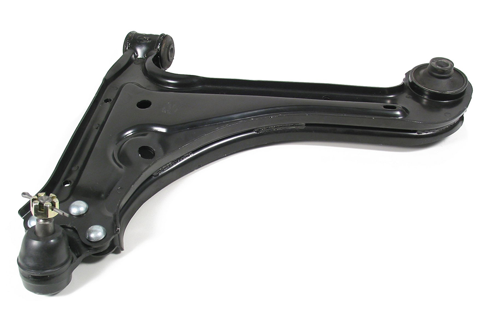

First change was the front control arm bushings. The Original 87-93 cars had a dual horizontal bushing setup as pictured below.
In 94 they changed out the rear bushing for a new vertical mount bushing. New 94-96 Control arm pictured below.
The two control arms share the same front bushing, its just the rear bushing that they changed the design on.
